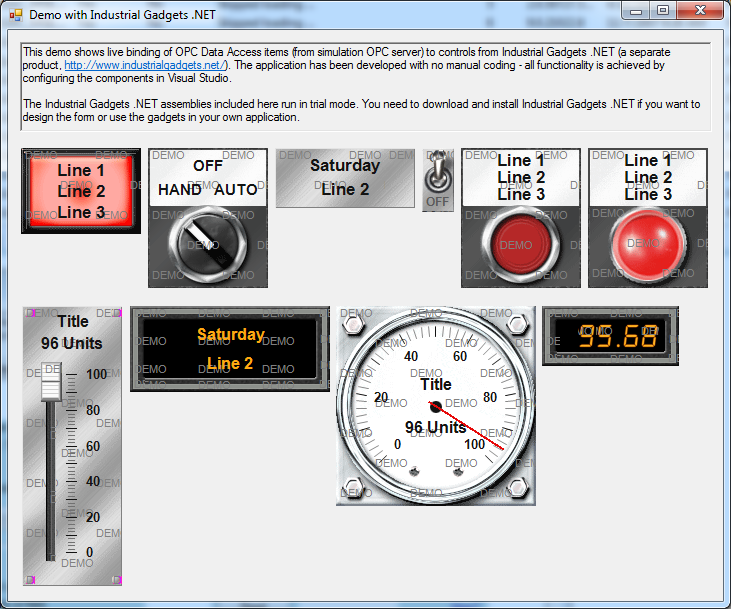

In the examples installed with the product, we provide a demonstration of the integration capability described above. There are demos that show how Live Binding can be used with several 3rd party products, some aimed directly at industrial automation area.

Following screens (click a picture below to enlarge) are taken from examples that are installed with QuickOPC. The demos show live binding of OPC Unified Architecture and OPC Data Access items to standard Microsoft controls, and to controls from 3rd-party products.
The applications have been developed with no manual coding - all functionality is achieved simply by configuring the components in Visual Studio. You can even monitor the OPC data online while you are developing your screens, without having to rebuild your application.
Screenshot - OPC Live Binding with Industrial Gadgets

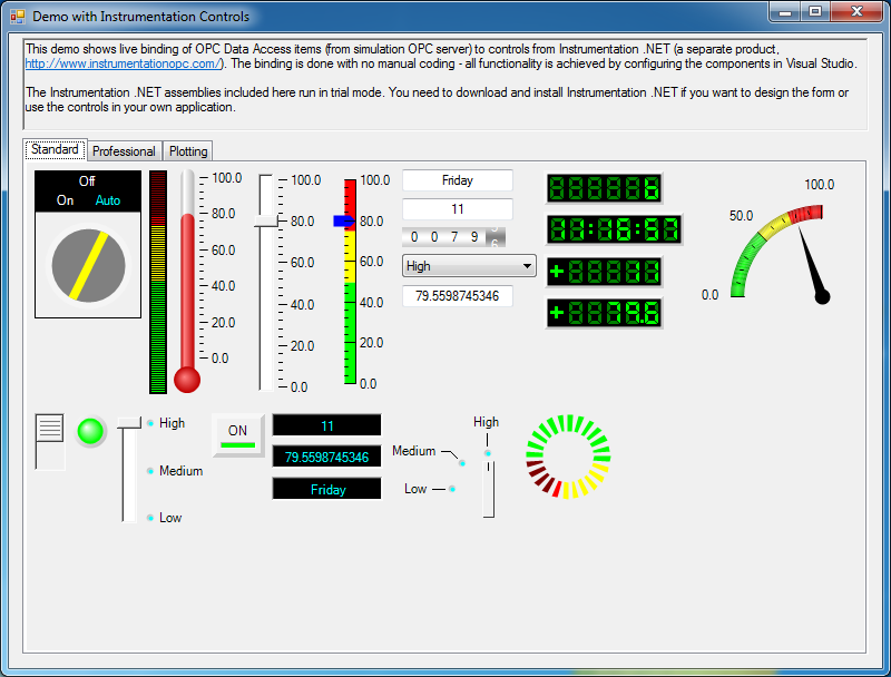

Screenshot - OPC Live Binding with Instrumentation Controls

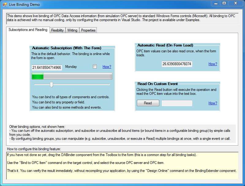

Screenshot - OPC Live Binding demo

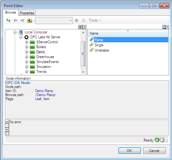

  6. In the "Point Editor" dialog, select Computers -> Local -> OPC Labs Kit Server -> Demo -> Ramp, and press OK.
    Screenshot - Point Editor dialog
